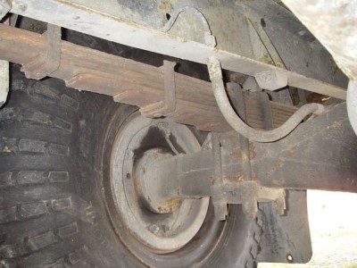

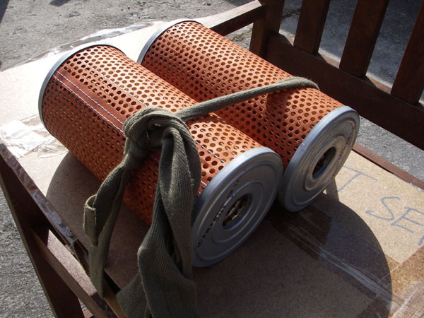

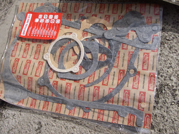

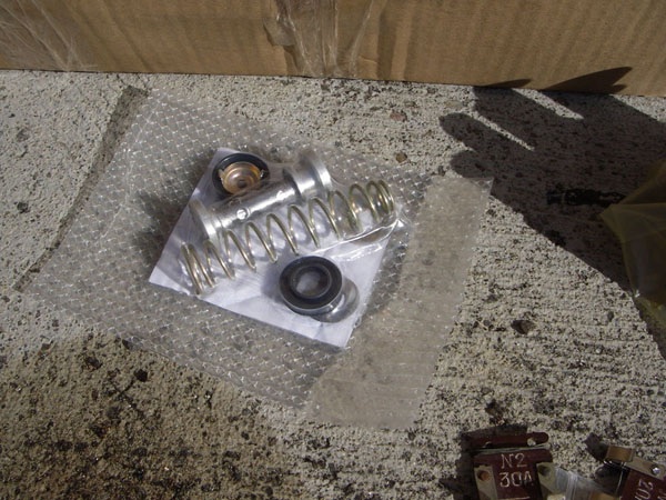

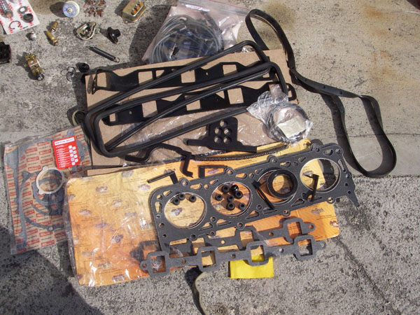

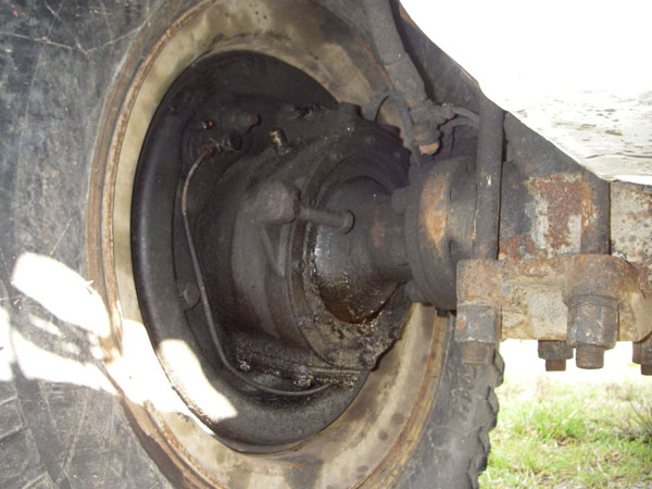

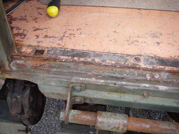

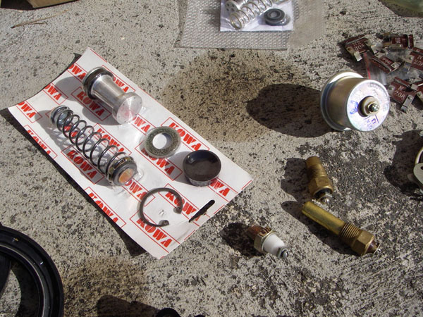

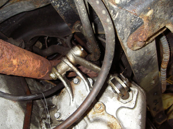

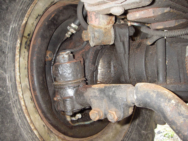

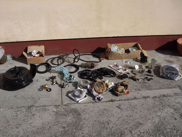

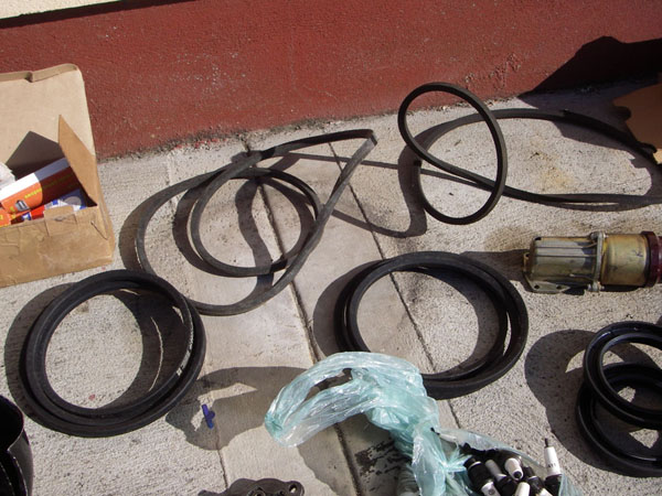

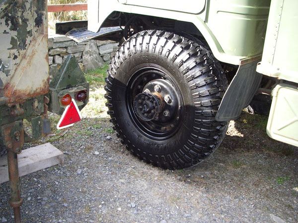

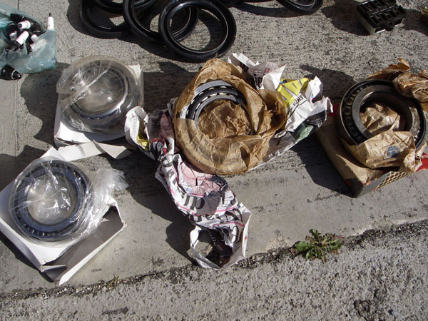

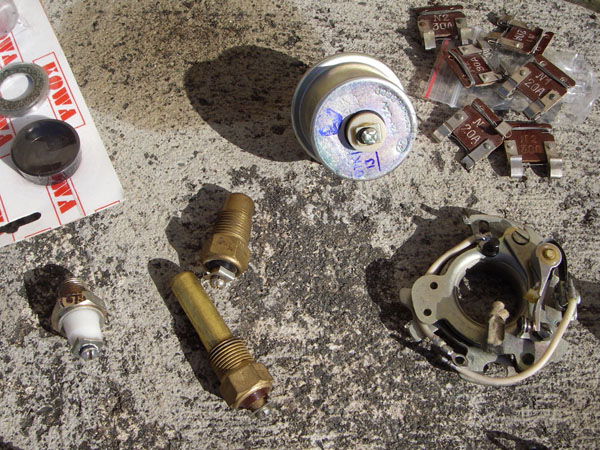

ok here are current parts photos and more parts will be sourced soon..

Re: Приезжайте в Ирландии и поможет мне решить мою ГАЗ 66

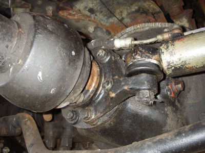

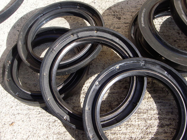

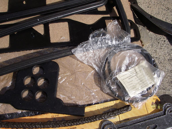

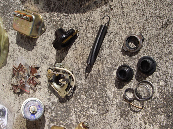

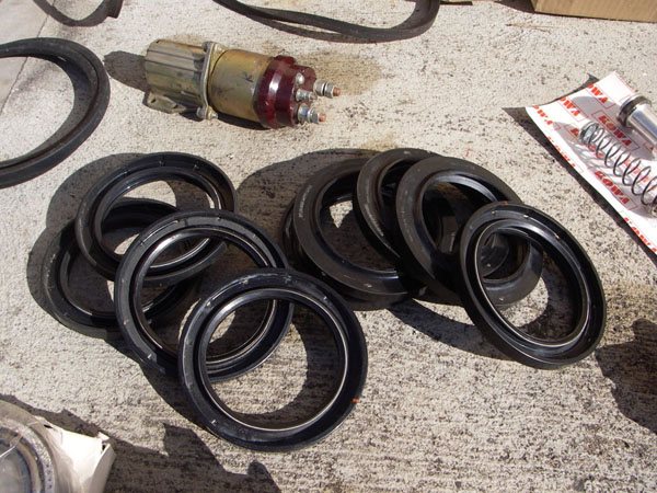

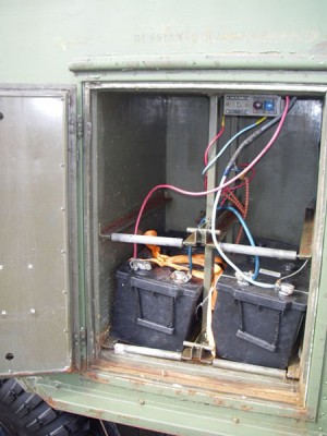

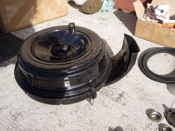

more

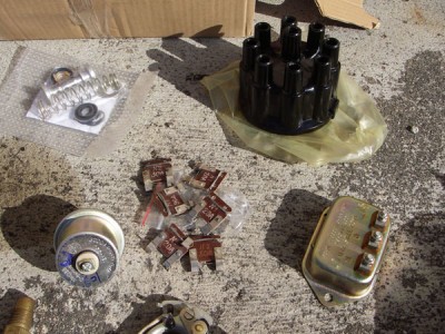

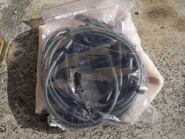

more

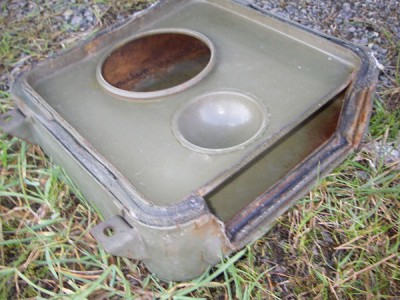

more

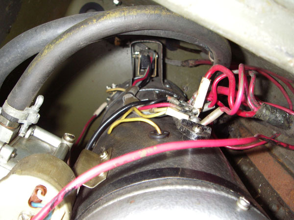

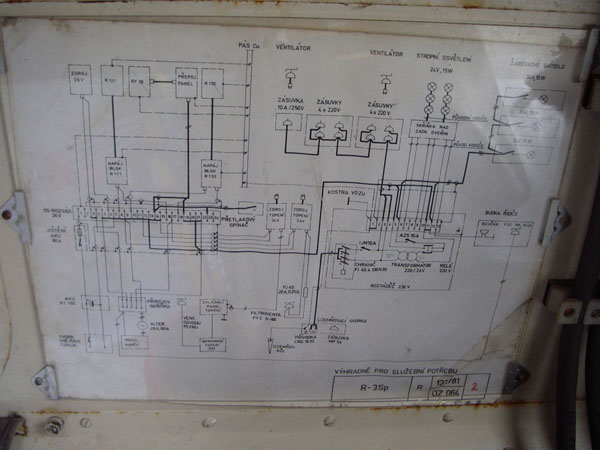

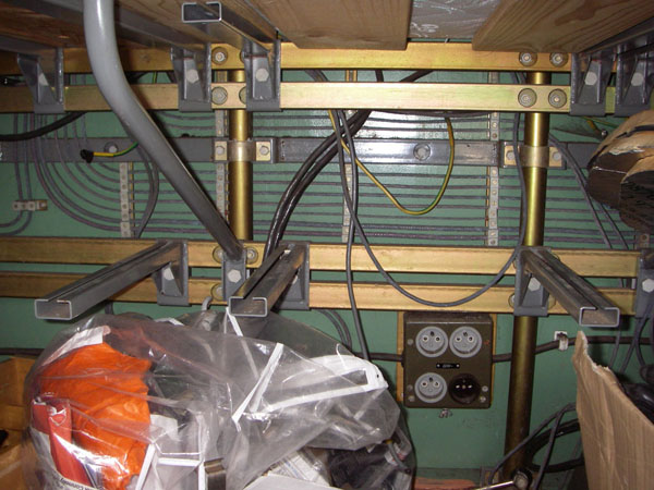

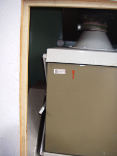

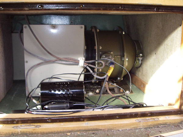

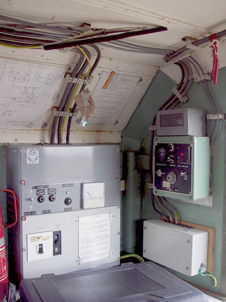

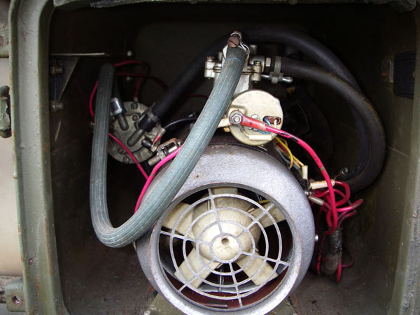

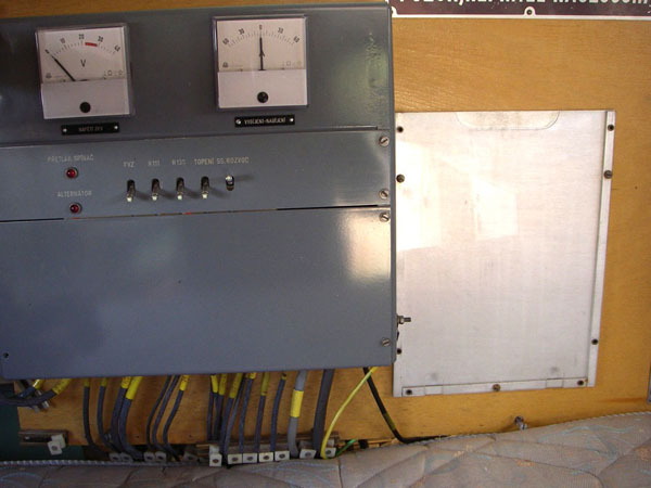

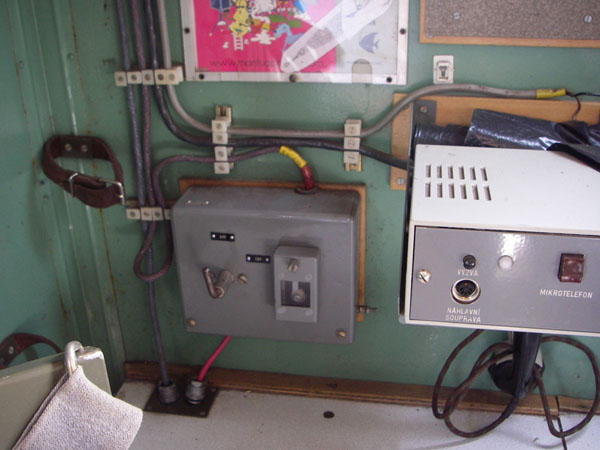

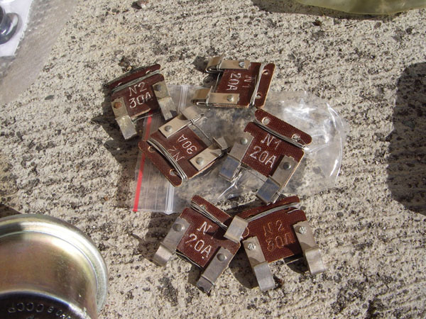

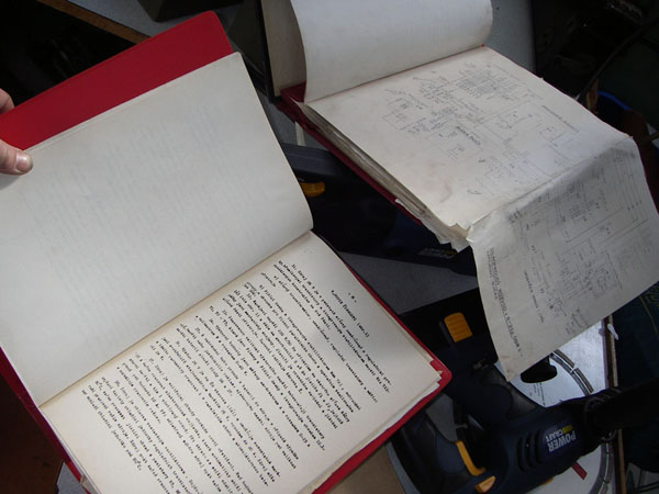

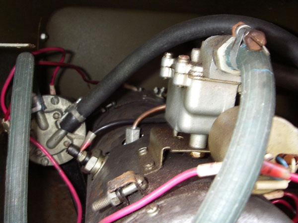

more photos, now showing electrics too

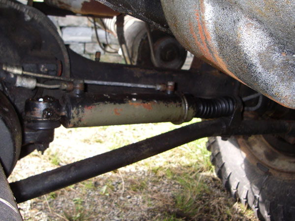

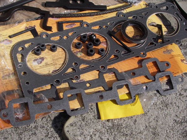

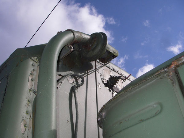

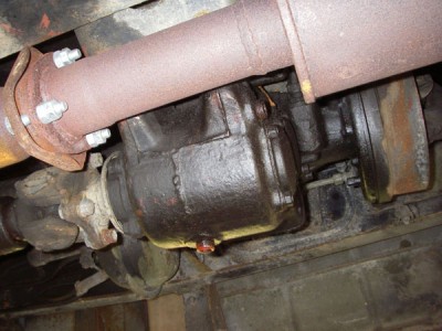

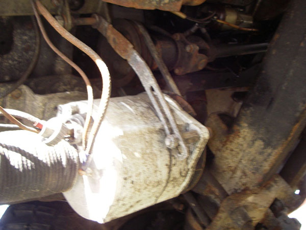

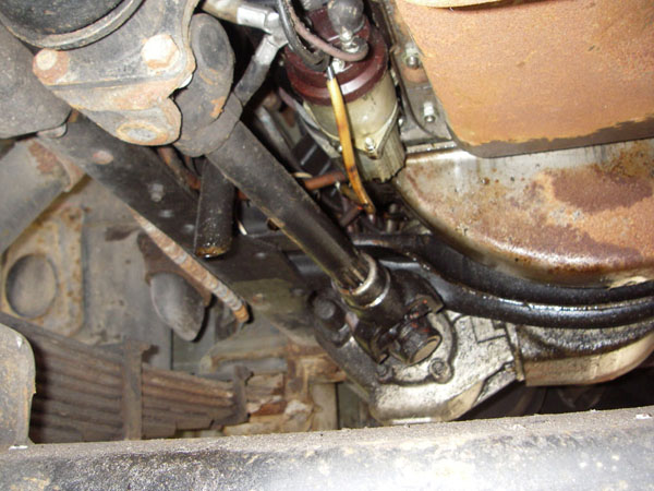

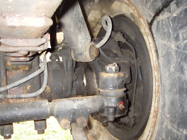

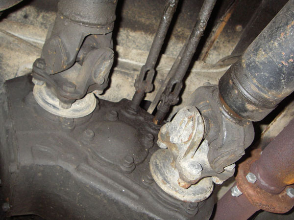

more photos

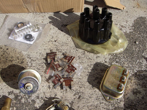

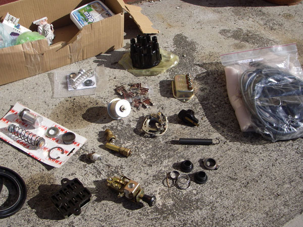

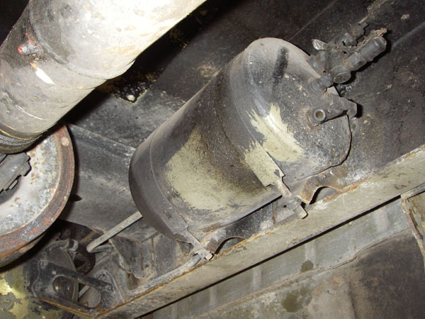

more

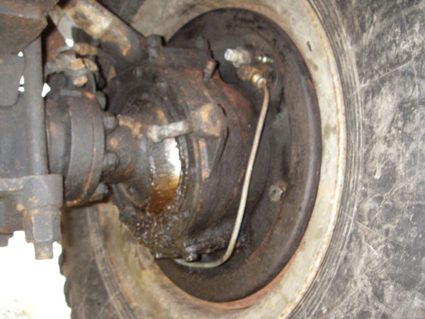

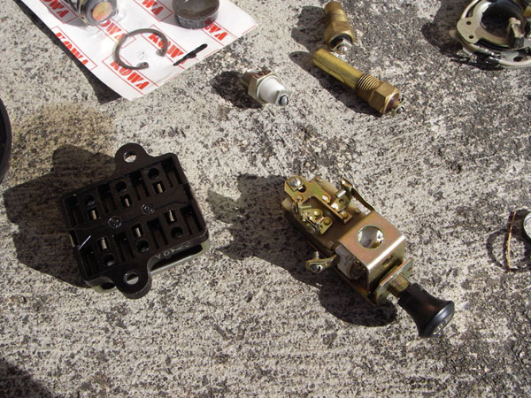

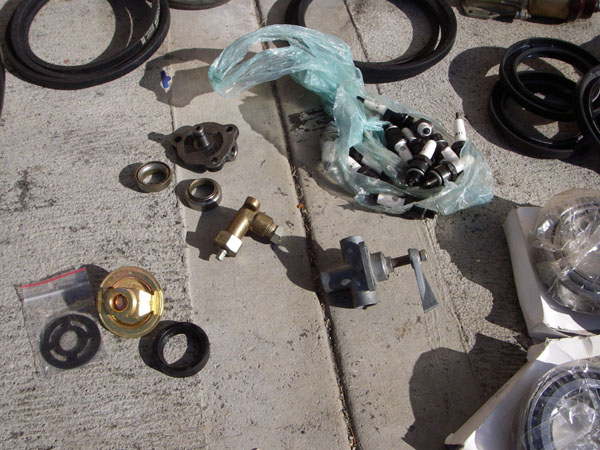

few more pics
more

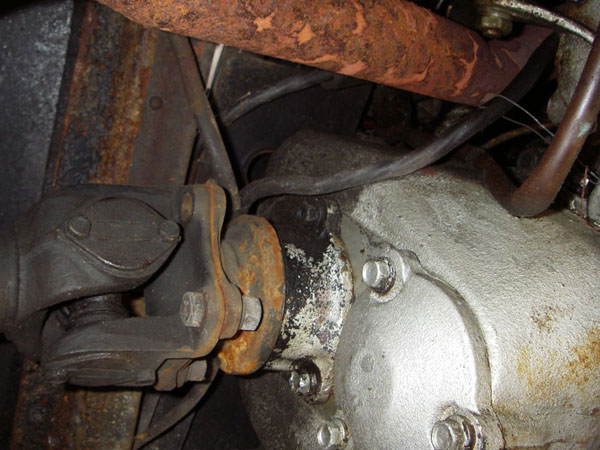

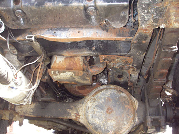

cash писал(а):few more

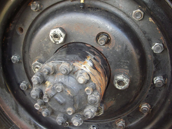

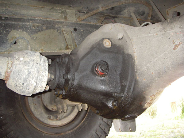

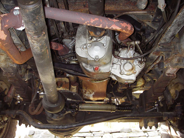

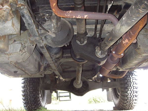

Good afternoon, Barra!
It's very good that some of the spare parts you already have, a lot of spare parts, you can imagine how much it costs in Ireland.
However, the value represent no more than 5 - 10% of the total.
I will shortly send you a list of spare parts that are required in the first place.
A lot of rusty places, whether you have a tool to remove the oxides, as well as compressor and a spray?
Preferred welder?!
Добрый день, Barra!
Это очень хорошо что часть запасных частей у Вас уже есть, запасных частей много, можно представить, сколько это стоит в Ирландии.
Однако ценность представляют не более 5 - 10 % от их общего количества.
Я в скором времени направлю Вам перечень запасных частей, которые потребуются в первую очередь.
Очень много ржавых мест, имеете ли инструмент для удаления окислов, а также компрессор и краскопульт?
Желателен сварочный аппарат?!

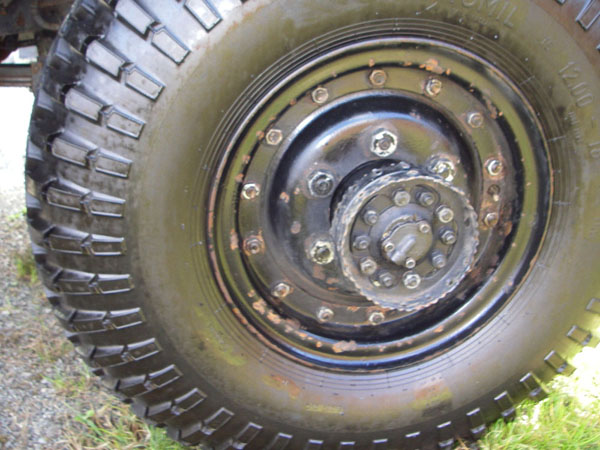

Work to be done:
We work carefully, not too quickly, cleaning parts as we service; derusting, cleaning, regreasing / priming with paint.
Working in style of quality restoration, preventing further corrosion.
We have two months, or 8 weeks full-time to do everything,
I have factored for delays of upto one week, I think we can do all this without pressure in 7 weeks:
Work target:
replace front left brake drum with new drum
fit new bearings front wheels and new seals
bearing seals replaced on rear wheels and clean regrease rear bearings
remove special cold weather engine heater next to manifold (after checking it works)
remove exhaust manifolds and derust, paint and fit new exhaust gaskets
change brake/clutch metal pipes for new, clean old ones as spares
remove master brake/clutch cylinder and clean, derust, service (fix leak)
change all rubber hoses for new under chassis and around engine
rubber hoses include all systems - brakes, oil, fuel, compressor... all old rubber pipes for new
open all brake drums and clean / service, check all for normal function
check back axle seal and font axle seal, maybe replace both axle seals for new, renew oil in axles
set foot pedals in driver cab for clutch and brake for proper action
check clutch / gears, replace transmission fluids and clutch disc if necessary
change engine rubber drive belts and steering rubber drive belt
draing engine oil and renew, drain brake fluid and renew
flush out engine coolant from radiator and engine and renew
check alternator, starter, distributor motor - ignition system service
check steering rack and rods, bearings, and pipes are strong... service
check steering column (a little loose at present), check bearings etc
set engine timing; tappets, wheel, distributor / points - set for best performance
inspect shock absorber arms are ok, rubber joints may need replacement
replace thermostats with new ones, oil, water, engine temperature - fit new all
check oil level and pressure indicators, clean fuel level indicator float
clean out compressor and check pressure is ok, check using light power tools off tank
service CTIS tyre inflation system and make sure its working properly
fit new tyre to spare wheel (should be ok to remove old tyre - it was off recently)
clean secondary fuel tank (has been dry for years - dusty inside) and get online
service electrics in driver cab and replace any old / burntout wiring - tidy up wiring, fix interior cab light
Get all electrics lights / indicators working in dashboard for driver... low oil, fuel... etc
Fit new spotlights to top of driver cab exterior and at back for reversing, wiring
fix heater/ demister in driver cab and check window water pump and wipers motor
get engine grill lever in driver cab connected for open/close front grill
test alternator on the PTO power take off via rele and transformer in back cabin to power 220v sockets ok
- some wiring and good understanding of electrics required for this important job so electics and heater work ok)
get petrol heater working properly, wiring must be checked thoroughly so safe and working 100%
remove any obsolete wiring from back cabin (remove any wiring not needed from original radio equipment which is gone now)
Don't know if this translation is any good - so I'm sorry for following errors - please excuse, for reference only:

уплотнения подшипников заменить на задние колеса и подшипники чистой заново смажьте задний
удалить с холодными подогреватель двигателя погоды рядом с многообразием (после проверки его работы)

испытания генератора по мощности PTO снимать через Реле и трансформатора в задней кабине к власти 220v розетки нормально
- Некоторые проводки и хорошее понимание электрики, необходимых для этой важной работы так Электрическое и порядке работы нагревателя)
получить бензин нагреватель работает должным образом, соединения должны быть проверены тщательно настолько безопасна, и работает 100%
удалить устаревшие проводки от задней кабины (убрать каких-либо проводов не требуется от оригинального оборудования радио, которое уже нет)
